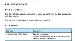

I would like to advertise some sensor data (temperature, humidity, pressure, co2, voc and other) by BLE advertising packet without any connection. I know, I can put it data to manufacture record(or Service data with Environmental Sensing uuids) and use my application to display it. But, at the moment I do not want to create an application and I would like to use readymade advertising format and android\ios application to display my data.
Could you recommend some applications and data format\structure for the display advertising data?
    There are no Bluetooth SIG specified data field for advertising of sensor data, so there are likely no ready-made app for this. You will need to put your sensor data into e.g. manufacturer specific data. If this is a iBeacon, you can also use your sensor data as Major and Minor values.
  • Bluetooth SIG provides "Service data" and it seems the next advertising data can be valid and it corresponds to the specification. I thought any application can parse it.

    Anyway, thanks! Seems you need own application)
