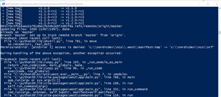

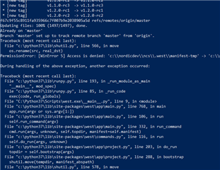

Hi, I am having an issues when i run the command
west init -m https://github.com/NordicPlayground/fw-nrfconnect-nrf
This is the response :
I found a similar issue here but i checkout the repo into a shorter path and still get the error.

  • Hi Theo,
    Could you please try to use the CMD prompt instead of Powershell?
    Use the commands and send me the responses:
    nrfjprog -v
    where python
    python --version
    west --version
    Then go through the following:
    cd <sourcecode_root>\ncs
    pip3 install -r zephyr\scripts\requirements.txt
    pip3 install -r nrf\scripts\requirements.txt
    pip3 install -r bootloader\mcuboot\scripts\requirements.txt
