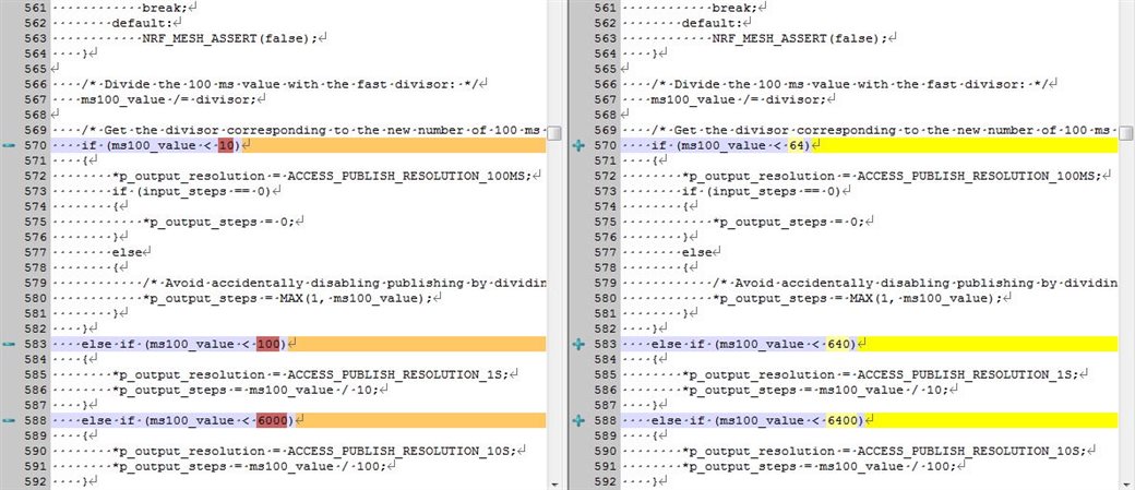

Losing publish timer resolution based on call of divide_publish_interval(..)
Hi
Using SDK for Mesh 4.0.0
I had a strange behaviour: Setting up a model with publication period 16s resulted to an interval of actually 10s. Multiples of 10s were working correct. So I assumed a resolution loss issue.
Changing the divide_publish_interval(..) function in the access.c as shown in the attached screenshot made it working. Can you confirm that this fix is necessary?
Thank you.
Regards, Timon
  • Some feedback from our developers;
    This seems to be an issue on our side.
    Your fix seems to be fine. However, the proposed fix from our developers is as follows:
    Instead of;
    '<64'
    '<640'
    etc..
    You can use:
    `<= ACCESS_PUBLISH_PERIOD_STEP_MAX`,
    <= ACCESS_PUBLISH_PERIOD_STEP_MAX*10`,
    etc..
    Because the max value for each step resolution = ACCESS_PUBLISH_PERIOD_STEP_MAX * step resolution.
