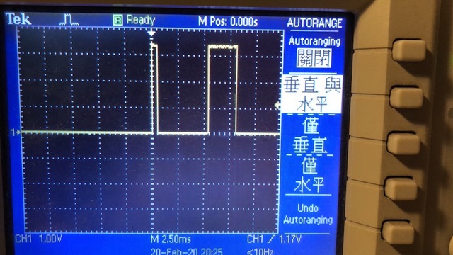

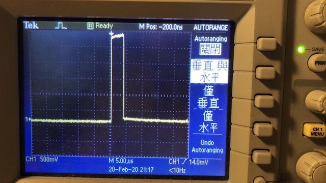

    As you suggested, I took some screenshots from a oscilloscope, toggling a GPIO pin.
    First one is taken when nrf_log is on (I use deferred log)
    Fig. 1
    Second one is taken when nrf_log is totally disabled.
    Fig. 3
    As you can see when log is on, the delay is between 500us ~ 2.5ms,
    and when log is off, the delay is ~ 4us.
    I have to say that this result surprised me, as I did not expect logging can make such big difference, even in deferred mode. Is it normal? or did I miss some configuration to make it correct?
