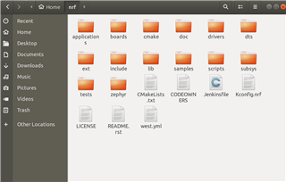

  • Hello Heidi,
    So I found the mcuboot folder in an older installation on my windows machine. I copied it to the ncs folder and ran west update. Now the sample builds fine for nrf9160_pca10090ns, but when I try to build it for nrf9160_20035ns (My actual target hardware). I get these errors:
