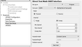

Two years ago our device was tested using nRFgo Studio 1.21.2.10 Direct Test Mode.
How can I know if the nRFgo software used BLE 4.2 or 5.0 during the tests? The only clue I have is nRFgo version.
It looks like there are no options for choosing it.
Best
    DTM isn't specific to a bluetooth LE version, it is a lower layer of testing than that, as it only focuses on the radio physical layer (RF PHY), by testing the radio capabilities.
    The qualification and listing of your product should state which bluetooth version you are using, normally inherited from the specific softdevice that you are basing your application upon.
