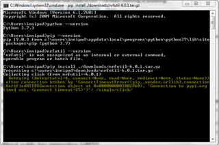

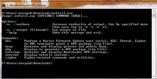

how to generate the public key for nrf52 DFU? Unable to install nrfutil.exe on my windows 7
How to generate the Public keys to firmware application?
Even i am unable to install the nrfutil.exe for my windows 7? what could be the issue?
Tried pip install for the nrfutil-6.0.1.tar.gz using  command line "c:\ pip install ./downloads/nrfutil-6.0.1.tar.gz" still unable to install. Always getting below message
Please help me on nrfutil installation and public key generation for the DFU.
