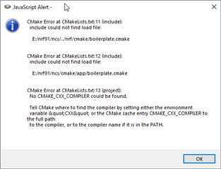

I've followed the instructions to install the nRF9160 and I can't import the asset tracker example.
This isn't the first time this has happened to me when trying out the nRF9160.

Loading solution asset_tracker.emProject
Executing load commands
cmake -GNinja -DBOARD=nrf9160_pca10090 -DBOARD_DIR=E:/nrf91/ncs/zephyr/boards/arm/nrf9160_pca10090 -DZEPHYR_TOOLCHAIN_VARIANT=gnuarmemb -DGNUARMEMB_TOOLCHAIN_PATH=C:/gnuarmemb -BE:/nrf91/ncs/nrf/applications/asset_tracker/build_nrf9160_pca10090 -HE:/nrf91/ncs/nrf/applications/asset_tracker -DEXTRA_KCONFIG_TARGETS=menuconfig_ses -DEXTRA_KCONFIG_TARGET_COMMAND_FOR_menuconfig_ses=E:/nrf91/EmbeddedStudio_ARM_Nordic_v442a_win_x64/arm_segger_embedded_studio_v442a_win_x64_nordic/html/configure_nordic_project_menuconfig.py
CMake Error at CMakeLists.txt:11 (include):
include could not find load file:
E:/nrf91/ncs/../nrf/cmake/boilerplate.cmake
CMake Error at CMakeLists.txt:12 (include):
E:/nrf91/ncs/cmake/app/boilerplate.cmake
-- The CXX compiler identification is unknown
CMake Error at CMakeLists.txt:13 (project):
No CMAKE_CXX_COMPILER could be found.
Tell CMake where to find the compiler by setting either the environment
variable "CXX" or the CMake cache entry CMAKE_CXX_COMPILER to the full path
to the compiler, or to the compiler name if it is in the PATH.
See also "E:/nrf91/ncs/nrf/applications/asset_tracker/build_nrf9160_pca10090/CMakeFiles/CMakeOutput.log".
See also "E:/nrf91/ncs/nrf/applications/asset_tracker/build_nrf9160_pca10090/CMakeFiles/CMakeError.log".
Project load failed
Reported error: solution load command failed (1)
