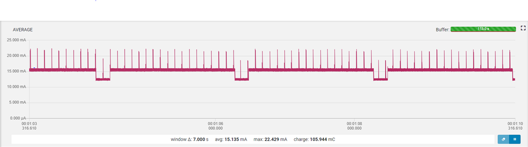

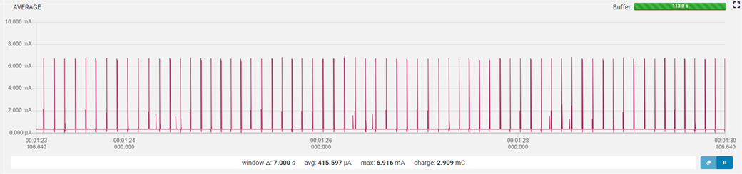

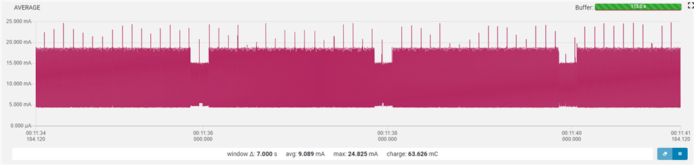

  • Hi Stian! The ppk is the nRF6707 and the development kit is PCA10040. With the USB it works better, I indeed managed to forget about it. Still, it doesn't work as intended. We tested it again on two DKs, with the ppk mounted on top and as external device. With these setups, the the results are different. To the DKs we uploaded the ble_app_beacon and the results are as below. The first plot shows the ppk on top of the DK, with SW2 set to DK of course. The second plot shows the plot when connecting the DK to the ppk via external DUT and P20 on the DK. We also connected the DK to the same supply as the ppk to see what happens, this is the third plot. As you can see there is still a small offset that I believe shouldn't be there.
