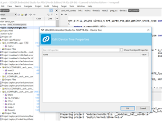

For some reasons i am unable to see any entries in my "Project->Edit Device Tree", is there anything i am missing?
regards
KK

I have reported this internally and I'm currently waiting for an answer. In the meantime, you can see the device tree by opening the file <project>\<build_folder>\zephyr\zephyr.dts after you've built the project.
Simon

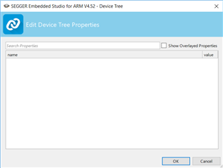

Currently seeing the same issue. SES version: 4.52, nrf Connect SDK version: 1.3.0
I never see it working in a graphical view, always review the zephyr.dts file in test editor.
regards
KK
Hey, Did you find any solution to this graphical issue?
No not Yet
