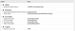

  • I upgraded Mac OS to Catalina. I also deleted pyenv and am using python3.7 installed by homebrew. Now I get this error.
    Loading solution at_client.emProject
    Executing load commands
    /usr/local/bin/cmake -GNinja -DBOARD=nrf9160_pca10090ns -DBOARD_DIR=/Users/fukuharayuusuke/nRF9160/ncs/zephyr/boards/arm/nrf9160_pca10090 -DZEPHYR_TOOLCHAIN_VARIANT=gnuarmemb -DGNUARMEMB_TOOLCHAIN_PATH=/opt/gnuarmemb -B/Users/fukuharayuusuke/nRF9160/ncs/nrf/samples/nrf9160/at_client/build_nrf9160_pca10090ns -H/Users/fukuharayuusuke/nRF9160/ncs/nrf/samples/nrf9160/at_client -DPYTHON_EXECUTABLE=/usr/local/bin/python3 -DCMAKE_MAKE_PROGRAM=/usr/local/bin/ninja -DDTC=/usr/local/bin/dtc -D WEST=/usr/local/bin/west -DEXTRA_KCONFIG_TARGETS=menuconfig_ses -DEXTRA_KCONFIG_TARGET_COMMAND_FOR_menuconfig_ses=/Applications/arm_segger_embedded_studio_v430c_macos_x64_nordic/html/configure_nordic_project_menuconfig.py

    Status
    nrf v0.4.0 => can open projects
    nrf v1.0.0 => can open projects
    nrf v1.1.0 => can open projects
    nrf v1.2.0 => fail in opening projects
    I run "pip3 install pyyaml" but nothing changed.
    $ pip3 install pyyaml
    Requirement already satisfied: pyyaml in /usr/local/lib/python3.7/site-packages (5.3)
    Any help?
