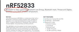

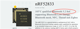

I find that nrf52 series can support Bluetooth 5.2 SoC in nordicsemi page, but it still shows Bluetooth 5.1 SoC in Product Spec.
Which one is right ? Is it just that the specifications are not updated in time?
Thanks.

Hi Helen,
the nRF52 Series SoCs are Bluetooth 5.2 ready, i.e. from a hardware perspective they can support all the new features in the 5.2 spec, i.e.
• Enhanced ATT
• LE Power Control
• LE Isochronous Channels
However, we do not have any Bluetooth Protocol stack that is Bluetooth 5.2. qualified yet, but this will come.
Best regards
Bjørn
