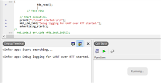

want to save data in flash
hi... i want to store data in flash , i will get the data periodically . i have merged the ble_app_uart +fstorage example . Even i am writing data to flash using write command ,when i am trying to print the data which is stored in flash , it getting printed but seems like it is not printing the data from flash ,,, in my case , my data will change periodically  so i need to save everything

    You need to wait for the WRITE_RESULT event in the event handler before you read the data back. If not, the write may not yet have happened since fstorage is writing asynchronously to flash. You can also use the wait_for_flash_ready() function between write and read to wait for the write completion.
    If you will be updating data in flash periodically, I would really recommend you to look into the FDS library instead of using fstorage. FDS provides file system functionality on top of fstorage to store data to flash with minimal risk of data corruption.
    Jørgen
  • Do you call fds_read() from somewhere? Also, there must be records written to flash with the File ID and Record Key in order to get to fds_record_open(). If there are no records with these IDs/Keys found by FDS, fds_record_find() will return FDS_ERR_NOT_FOUND and not enter the loop.
  • I see the code you posted, but this does not include the full file. There is no information about how you call the functions. Do you wait for the successful FDS_EVT_WRITE event after writing before reading? FDS is also asynchronous, if you do not wait, the read function will not find any records.
  • Here i am dropping my main code

  • I tested your application. As I suspected, your call to fds_record_find() inside fds_read() does not return FDS_SUCCESS and the record will never be opened. This is caused by the application not waiting for a successful FDS_EVT_INIT event before performing the write. You can check in the FDS example in the SDK, how to fix this using a flag.
  • yes i am done ,but while printing the read data , i am getting the garbage values , please help me with this
