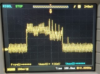

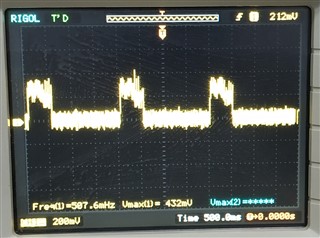

  • I want reduce my average current consumption, for now I have external (2 second) interrupter which wake nrf52832 from sleep.
  • So I have following results: 1500 ms with 100 uA in sleep and 500 ms with 3500 mA in advertising (300 ms init + 200 ms advertise.
  • So my average current is 1220 uA
  • used shunt resistor 100 Ohm
    Please share your source code if possible. It's not clear why you have to repeat the init routine every time. Usually, you do it once on startup. Also, it looks to be a burst of advertisement events during the 200 ms advertisement period, is that intentional or do you really want it to advertise 1 time every 2 seconds?
    Note that it should be possible to get an average current of around 7-8 uA if you just advertise at 2 second intervals. Try our online power profiler https://devzone.nordicsemi.com/nordic/power/ if you want to estimate excepted current consumption for other scenarios.

    for now my working steps looks like this:
    I have external interrupt pulse (every 2 sec)
    1. after reset reason 0 (power on) I perform global init then
    2. when I finish advertising (or some other process) I configure nrf_gpio_cfg_sense_input() and call for sd_power_system_off() to reduce consumption
    3. when nrf52 catch interrupt pulse(reset reason 65536)->init advertise-> start advertise with 20ms interval during my custom timeout of 200ms->goto step 2.
    I see a possible improvements:
    1. reduce my custom timeout -> reduce num of advertise packets (add some delay to other device connection)
    2. reduce num of process which I initialize after startup
     Yes, I want advertise one or few times every 2 sec to archive low average current. Could you describe a clear steps to archive low current with advertisement, should I call sd_power_system_off()  during 2 sec interval?
    Also what is normal standby current for nrf52832 without advertise? I see its around 3 mA (58 μA/MHz * 64)
    Thx!
