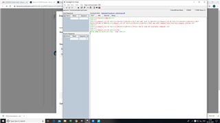

Thanks Amanda ,
i tried with checking all u mentioned but i am not able to interface UART for example cli code (ble_central_peripheral/ble_app_interactive).
issue is like after configuring external pins as uart i did get data in terminal.
can u help with providing cli example for dongle to communicate with uart. (if not can u suggest any link to to get that code).
if not can u brief about steps to get what i have asked above.

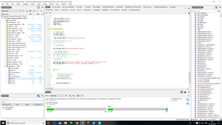

thank you for replay,
i have commented the ble part code to check with uart it is replaing and at some part code is getting crash , can u tell what might be the issue amanda
