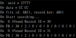

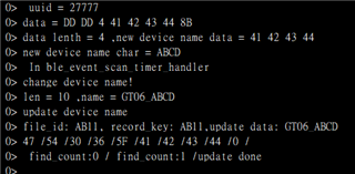

massage from bluetooth is data in log
DD DD is id
4 is lenth
41 42 43 44 is ABCD
and I concade it to GT06_ABCD
no error from fds_record_update
below:kls_fds_read
Any help is appreciated. Thanks.
