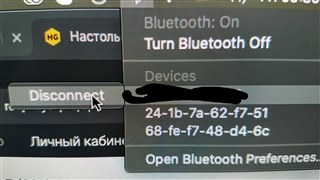

A bit more detailed:
A bug has been detected on the device under development. It is connected with the fact that if you try to disconnect a connected device on an iMAC Catalina, then it automatically reconnects.
On Android, this works well.
To exclude my mistakes I used an example from nordic HID_KEYBOARD. But it has the same problem.
In the example, I disabled
init.config.ble_adv_directed_high_duty_enabled = false;
init.config.ble_adv_directed_enabled = false;
Included logs received the following:
00> <info> ble_bas: Battery notification has been sent using conn_handle: 0x0000
00> <info> app: Disconnected
00> <info> app: m_whitelist_peer_cnt 2, MAX_PEERS_WLIST 8
00> <debug> app: pm_whitelist_get returns 1 addr in whitelist and 1 irk whitelist
00> <info> app: Fast advertising with whitelist.
00> <debug> peer_manager_handler: Event PM_EVT_BONDED_PEER_CONNECTED
00> <debug> peer_manager_handler: Previously bonded peer connected: role: Peripheral, conn_handle: 0, peer_id: 0
00> <debug> peer_manager_handler: Event PM_EVT_CONN_SEC_PARAMS_REQ
00> <debug> peer_manager_handler: Security parameter request
00> <debug> peer_manager_handler: Event PM_EVT_PEER_DATA_UPDATE_SUCCEEDED
00> <debug> peer_manager_handler: Peer data updated in flash: peer_id: 0, data_id: Peer rank, action: Update
00> <debug> peer_manager_handler: Event PM_EVT_LOCAL_DB_CACHE_APPLIED
00> <debug> peer_manager_handler: Previously stored local DB applied: conn_handle: 0, peer_id: 0
00> <info> app: Connected
00> <debug> peer_manager_handler: Event PM_EVT_CONN_SEC_START
But the problem remained the same. In addition, I tried to reset the pointer to p_peer_addr and disable whitelist, it did not help.
I don’t understand something or is it an iMAC problem?
Thanks!
