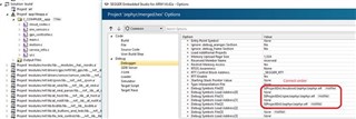

The other issue I am having is connecting the debugger to the dev-kit. I am using the latest Segger Embedded studio v4.42a. The segger is unable to download the hex into board. I have to use nrf Connect Programmer to load the hex file.
I have tried different methods
Debug>>Go
Target >>Connect J Link     Target >>Download File>>Download   Intel Hex file
I tried to connect the debugger after programming by using Target>>Attach debugger and it attaches me to the SPM project and does not allow to put any breakpoint in the main application. I have used the older versions of SES before with SDK v1.1.0 and earlier the debugger was working fine in that. A Debug>>Go was able to load and connect debugger.
  • Hi.
    We are seeing some issues with SES v4.42. They are reported internally, and we are working on fixing them.
    As a workaround, you can downgrade the J-Link version used by SES to v6.50 by copying the files in JLink=6.50.zip to the bin folder in your SES install directory (replacing any previous versions that might be there).
    You must also ensure that SES loads the elf files that your application consists of in the correct order (MCUBoot first, then SPM, finally your application). If your application does not use MCUBoot, SPM would be first, then your application.
    JLink_6.50.zip

    I was able to fix my SES with your files, thanks for that.
