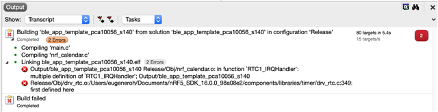

    Now, I have questions, what does this line mean?
    CAL_RTC->EVENTS_COMPARE[0]
  • Yes, that is correct. That line is a reference to a register in the RTC peripheral itself. CAL_RTC is defined in the header, allowing you to easily change it if the default RTC instance used is occupied by other libraries (RTC0 is by default used by the softdevice when running BLE application).
  • Thanks for your reply. However, whenever I try to use RTC1 by changing #define in the header it returns this compile error. So I had to use RTC2 instead because it does not return any error. Could you kindly explain this situation please? Thank you !!
