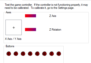

Hello All,
I'm updating an application for the nRF52840 that requires it to enumerate and act as joystick. I'm able to run the HID generic example in SDK15.2 on the BMD340 dev board and I used that as a starting point to modify. The device seems to enumerate correctly and is detected as a game controller, however none of the button presses are updating the values on the host (PC) side.
I have attached the main.c file and will try also provide relevant snippets in the post.
The descriptor looks like so, I tried changing it so that all report sizes were 16 bits to see if that was the issue, but it did not help:

The PC recognizes all the axis:
but pressing the buttons on the dev board does not change the outputs, buttons or axis. I don't see any failed transfer on wireshark or the like.
Any ideas? Thank you for your time and I will answer any questions I can.
