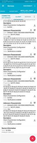

I am working on the client program to retrieve the value from 4 characteristics at the same time using notifications. I have already done with the server program. Using nrf connect to connect with my program, it looks like this:
I would like to collect the value from these four characteristics using notifications. Here' s the code to update 4 characteristic data on server:

1. Do you have examples that have multiple characteristics that need notifications in one service? I read the code of ble_app_hrs_c, but this program is not what I want.
2. If I can get retrieve these 4 characteristics data on the client, how to differentiate them?
    In the ble event, the handle in the ble_gattc_evt_hvx_t data structure is the attribute handle which identifies the characteristic. (Not to be confused with the connection handle, which is found in the ble_gattc_evt_t structure that holds the ble_gattc_evt_hvx_t structure in its params.hvx field.)
    For examples on how to handle this, please have a look at the client service implementations in <sdk folder>/components/ble/ble_services (the folders ending in "_c"). Typically there is an on_hvx() function that checks the handle, e.g. for the battery service client in ble_bas_c.c:
