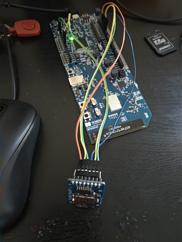

    Can you please provide more information about your setup? Can you take a picture to show how you have connected?
    Have you ensured that the pins are correctly configured in the board controller? P0.13 on the board controller must be set to enable these pins.
    To minimize editing the board controller, can you please route SPI3 to P0.10 - P0.13  instead? These are found on P19 and should be directly available.

    I am using adafruit micro-sd breakout board and kingston micro sd card 8GB which is formatted to FAT32 Filesystem.
    Connections are as follow:
    SCK (Pin 11) -> CLK
    MOSI (Pin 12) -> DI
    MISO (Pin 13) -> DO
    CS (Pin 10) -> CS
    Picture of the setup:

    I checked the drivers and it looks correct. I checked the SD card commands, they are also correct. In previous version there was issue but it is fixed now for this version. Still that error comes.
    So the problem is either in disk_access_spi_sdhc file or in the sd card. Because SPI is getting initialized.
