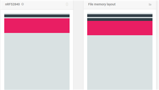

We were able to successfully finish steps 1 and 2. However, here is what we get after flashing merged .hex file into nRF52840 device:
What is flashed seems not to be equal to merged .hex file. Consequently, we are unable to debug application from SES.
Do you have any idea what we are missing here?
