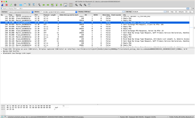

I'm new to sniffing BLE. I'd like to determine the min and max connection interval and other connection parameters (MTU, slave latency, supervisory timeout, etc.) of a peripheral. I don't have access to the firmware. I have Wireshark+nRF Sniffer for BLE 3.0.0 installed and running my my Mac (10.14.6). I can see advertising, connection requests, etc. I've attached a screen capture. Where do I look to find these connection parameters?
Many thanks,
Tim
  • Hi Tim,
    you'll find the connection interval, slave latency and supervision timeout in the connection request ( CONNECT_REQ) under Bluetooth Low Energy Link Layer -> Link Layer Data
    For the MTU size you need to look for Exchange MTU Request/Response packets
    If you do not see any Exchange MTU Request/Response packets, then the default MTU size of 23 is used.
    Best regards
    Bjørn

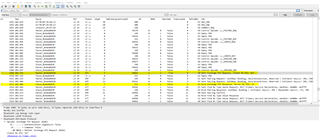

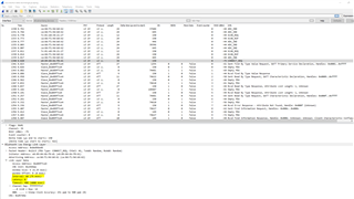

    I've sniffed connection parameters and see the following:
    Simblee
    Window Size: 3 (3.75 msec)
    Window Offset: 12 (15 msec)
    Interval: 24 (30 msec)
    Latency: 0
    Timeout: 72 (720 msec)
    BL652
    Window Offset: 21 (26.25 msec)
    Interval (24 (30 msec)
    Latency: 0
    Timeout: 72 (720)
    Is it possible that the differing Window Offset is causing the difference? Any other parameters to consider in explaining this? Possible that there's some latency in the SoftDevice or other aspects of Nordic software?

    What doe Window Size/Offset do? Possible impact on latency? Possible that the peripheral set these?
     I have been looking at the Bluetooth Specification and the Window offset is used to inform the peripheral that it should start listening for the first data packet .
    Its the Central that dictates the Window offset and the central uses the Window offset to place the first connection event away from other BLE events that have already been scheduled, e.g. other connection events, to avoid collisions.
    So the Window offset only decides the time between the connection request packet and the first connection event, after the first connection event the peripheral will listen for data packets from the central at the connection interval.
    Hence, I do not think that this the cause of the latency you're seeing. How do you measure the latency, you stated that your app is measuring time between sensor events on two different peripherals. So the iOS app connect to multiple nRF52's ( Simblee, BL652 or nRF52 DK) , but I am not quite sure how you measure the latency. Do you measuree the time difference between the reception between the first and last sensor data packet with a specific sequence number?  Could you elaborate on how you measure the accuracy?
