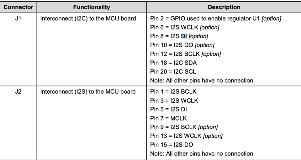

How to interface DA7212 codec with nrf52840?
I am testing DA7212 with my nrf52840 and i have made connections but i am not sure if thats right. Also i am trying to use i2s loopback example from sdk.
i need some guidence

    Are you familiar with how to find the correct pins on the different headers mentioned in the datasheet?
    yes i have some idea about it
    After reading the datasheet, this seems incorrect to me. Please see the J5 - Speaker output section of table 2 in the datasheet you linked.
    okay thanks for this i have made the necessary connections now how do i proceed.

    Have you taken a look at the schematics for the DA7212 development kit? Please have a look at the different wiring options in the second page, and cross reference them with the table you linked in your previous comment. Pay attention to the different designation on each of the [option] connections, to see which option is the right one for your application.
    If you are unable to identify the correct connections, let me know and I will take a closer look at the provided schematics along with your suggestions.
