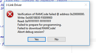

Hi all.
Here I am getting the RAM code error while flashing with J link Plush using IAR IDE.
Can you please suggest me.

Can you try running nrfjprog --recover command before programming, as suggested in this thread?
Have you managed to program this board before? Is it a DK or a custom board?
