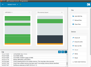

I have tested the DFU Serial example successfully and it works. However, for development purposes I wanted to get the DEBUG version of serial DFU working.
Everything works as expected until the firmware is flashed into the device. But when it is time for the app to boot, it fails as seen in the attachment.
Also, from the memory map it is observed that the application is successfully flashed.
Memory map
serialDFU_debug.log
What could be the reason for the failure to load the app?

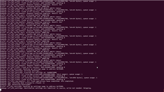

  • Hello Edvin,
    I removed the app_error_fault_handler() from main amd added DEBUG to the processor defines.
    I am not able to find a line that says "ASSERTION FAILED" in the debug/info log messages.
    What is happening after I removed the function and added DEBUG to processor define?
    - After flashing the image, the controller stays in DFU mode. It is not switching to the APP, but unlike before it is not getting stuck in between DFU and APP switching.
    Log from nrfutil: after_DEBUG.log

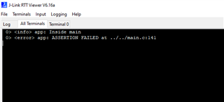

    Image of the debug messages on RTT Client:
    After adding DEBUG to processor define
    Can you please take a look at these files?
    Navin

  • Hello Edvin,
    Yes, I received a similar message when I added ASSERT(0) in the main.
    "<error> app: ASSERTION FAILED at /home/$USER/Test/nRF5_SDK_15.3_edit/components/libraries/bootloader/dfu/nrf_dfu_validation.c:988"
    No I did not see a message mentioning fatal error. Although it mentioned "No firmware to activate."

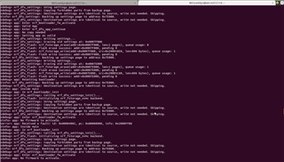

    Debug Log
    Process: emStudio
    <info> app: Inside main
    <debug> app: In nrf_bootloader_init
    <debug> nrf_dfu_settings: Calling nrf_dfu_settings_init()...
    <debug> nrf_dfu_flash: Initializing nrf_fstorage_nvmc backend.
    <debug> nrf_dfu_settings: Using settings page.
    <debug> nrf_dfu_settings: Copying forbidden parts from backup page.
    <debug> nrf_dfu_settings: Destination settings are identical to source, write not needed. Skipping.
    <info> nrf_dfu_settings: Backing up settings page to address 0x7E000.
    <debug> app: Enter nrf_bootloader_fw_activate
    <info> app: No firmware to activate.
    <error> app: Received a fault! id: 0x00004002, pc: 0x00000000, info: 0x2000FFB8
