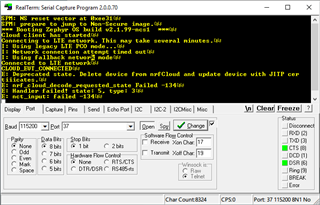

Unable to connect to LTE using nrf9160 dk
I have an nrf9160 dk on the latest firmware (i.e. mfw_nrf9160_1.1.1) and I have been unable to establish stable connection to LTE network using iBasis SIM. I tried using the following asset tracker applications:
  • nrf9160dk_asset_tracker_nbiot_legacy_pco_2019-11-29_d3130d77,hex
  • nrf9160dk_asset_tracker_nbiot_2019-11-29_d3130d77.hex
In both cases, either the LTE modem is Greyed out or is blinking Red and Yellow in the LTE Link Monitor application in nRF Connect. Sometimes it becomes Green but only for a small moment of time.
With the same SIM card, I have been able to connect to the LTE network and have the asset tracker running flawlessly on my Thing91 device using the following application:
  • thingy91_nbiot_legacy_pco_dfu_2019-11-29_d3130d77.hex
I know that there is no CAT-M1 coverage in the region so I am not trying using that.
I am attaching the log file so you can have a look for yourself.
Can you please let me know what is the issue and how I can fix it?
Thanks.
Haris Ahmed

    Then, I tried running cloud connect on my nrf9160dk and found this to be the output:
    So, I reset the device from the nrf Cloud and updated the certificates and connected to the cloud using asset tracker application. This time I was successful and can see the data being sent onto the cloud.
    In conclusion, the problem was with the certificates.
