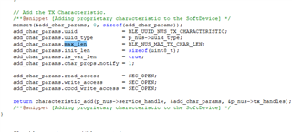

    Why do you need to ask the softdevice for the max length?
    The max length is provided from the application to the softdevice when you declare the characteristic. The max length of an attribute is defined when they define the attribute. For example here:
    So the application just needs to store that value somewhere. I don't see the point of having the softdevice to tell the max length.
    -Amanda H.
