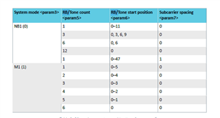

for example,AT%XRFTEST=1,1,5,8300,17,1,0,6,0,0 is right? Could you provide the RX waveform please?
This looks correct.
You will need to clarify what you mean by this.
I want to LTE CAT-M1 waveform?for example:LTE_CATM1_10MHZ_640MS_M_v3
I don't think that's possible. The receiver in the modem does not provide any sort of waveform, just a bit stream.
