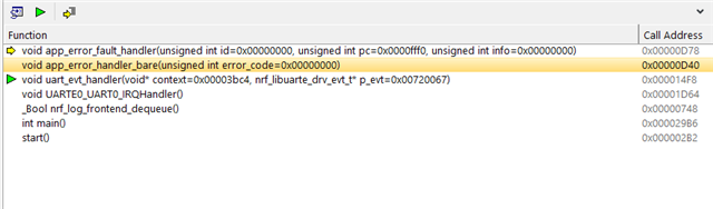

  • You can choose the build configuration, release or debug, in the upper left corner in SES:
    If you are using the libUARTE example, logging over RTT should be enabled by default. You can read the logs using J-Link RTT Viewer. It is also possible to view the logs in the debug terminal in SES while debugging, but you may need to unset the following config in sdk_config.h:
    // <q> NRF_FPRINTF_FLAG_AUTOMATIC_CR_ON_LF_ENABLED  - For each printed LF, function will add CR.
    #ifndef NRF_FPRINTF_FLAG_AUTOMATIC_CR_ON_LF_ENABLED
    #define NRF_FPRINTF_FLAG_AUTOMATIC_CR_ON_LF_ENABLED 0
