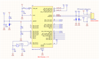

I am working on a product development that uses an nRF52832 (through a LAIRD BL-652 module).
We have a voltage point (named 5V), that is connected to SIO_28 GPIO through a voltage divider. This voltage divider should give us 3V at the GPIO.
Unfortunately the GPIO always read 0. When measuring with a multimeter, we get 0.6V instead of 3V.
If we cut the trace between the divider and SIO_28, we do get 3V at the voltage divider's output.
If we connect the voltage divider to SIO_02 instead of SIO_28, the GPIO reads correctly and we do get 3V (2.95V actually).
Here is our schematics :
Do you have any idea ?
