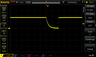

I have a battery powered device powered by a dead-man switch.  When the user presses the power on button, the NRF52840 holds this dead-man switch on to enable power to the whole system with a GPIO output.
I need to be able to boot into the DFU BLE bootloader without having this deadman output reset.  If I just call sd_nvic_SystemReset(); or NVIC_SystemReset();, I get a toggle on this pin and loose power. The pin drops low for about 2 ms, enough to disable the power switch.
I believe, per the data sheet, that all pins are reset to inputs on system reset.  This seems to be new on the NRF52840 as my old projects with the NRF52832 did not reset my output pins I reset the system.

See below for the pin toggle screenshot:
  • The pin drops low for about 2 ms, enough to disable the power switch.
    Just put an R+C low pass filter on the ouput pin.

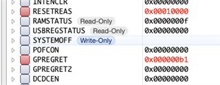

    I then set a breakpoint on the reset vector and at main in the DFU Boootloder.
    I am definitely reseting using the SYSTEMOFF method as I check RESETREAS and can verify the register value and the correct GPRET value.
    However, the deadman switch output NRF_P0->OUT gets cleared as well as PIN_CNF[17] is reset to an input (0x002).
    It does look like the bootloader preserves the SENSE pin 10 setting, but all other pins are reset to inputs and the OUT register is reset to 0.
