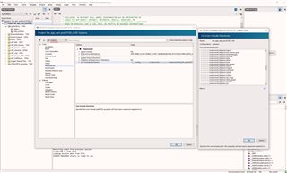

    3. When adding .h files to your SES project, we recommend adding user include directories in the preprocessor options of your project (see picture below).
    4. For preprocessor definitions, this comes down to your personal preference. I for one, prefer using the preprocessor definitions from the options for setting definitions in my project, but this is entirely up to you.
