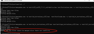

sdk16 ERROR: The hex files cannot be merged since there are conflicts.

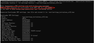

Question 1:
This is only required for bootloaders from nRF5 SDK 15.1 and newer.
Question 2:
cd ../
nrfutil settings generate --family NRF52 --application test/buttonless.hex --application-version 3 --bootloader-version 2 --bl-settings-version 1 test/settings_buttonless_s132.hex
pause
cd ../
mergehex.exe -m test/s132_nrf52_7.0.1_softdevice.hex test/buttonless.hex -o test/sd_buttonless_s132.hex
mergehex.exe -m test/sd_buttonless_s132.hex  test/bootloade.hex -o test/sd_bt_buttonless_s132.hex
mergehex.exe -m test/sd_bt_buttonless_s132.hex test/settings_buttonless_s132.hex -o test/all_buttonless_s130.hex
pause
bootloade.hexbuttonless.hex

    1. I don't understand your question. The bootloader setting backup is only needed from SDK v15.1
    2. Which compiler did you use ? Did you change the IROM1 size of the bootloader ? I can see that the bootloader.hex file has some code in address 0x7E000 which it shouldn't. If the bootloader too big to fit in from address 0x72000 you should move it to address 0x71000 before increasing the max size for IROM1.
  • Hi Hung:
    Which compiler did you use ?---------SES
    Did you change the IROM1 size of the bootloader ?------Only dfu_public_key.c
    Use bootloader: nRF5_SDK_16.0.0_98a08e2\examples\dfu\secure_bootloader\pca10040_s132_ble_debug

  • Please move the bootloader FLASH_START  to address 0x71000 instead of 0x72000. (in linker - common project setting)
