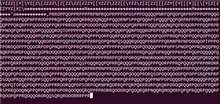

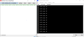

    I would imagine its some kind of formatting issue maybe.
    Here is what is I see on the peripheral side:
    It seems like the values on the left is getting sent.
