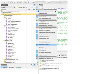

I now have 4pcs PCA10056 and 4pcs PCA10059 for the development of our BT Mesh products by nrf52840 of Nirdoc. I have completed the installation of the tool chain, but my Segger Embedded Stuido cannot display the header file because I have not applied for a valid license. The website of Nordic says that an unlimited free license Segger Embedded Stuido can be used to develop Nordic products.
What can I do to get my free license for Segger embedded stuido?

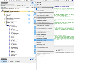

    How I can open the .h files without  building
    As I said, The SES browsing facilities should still work without building the project - you can right-click a header in the source to open it.
    The other IDE tools, all of the .H files and .c files can showed
    They can be - but they usually aren't.
    There is no need - they can easily be accessed other ways.
    You could add them all to your SES project if you wanted.
    Maybe try it - see how long it takes to become tedious, and to realise why people don't do it...?
