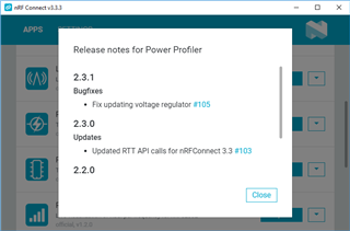

  • If the Power Select (SW4) is set to DK, the regulators will not be used at all, which is why you are not seeing any change in the voltage.
    If you set the switch to Reg, you should be able to use the voltage regulator with the latest release (2.3.1):
  • I am facing the same issue with power profiler 2.3.1 with this same setup. Also, I cannot set the regulator voltage to exactly 3000 mV. It either goes to 2996m V or 3005 mV. How can I set the voltage to exactly 3000 mV?
  • I'm not able to reproduce this on my setup. Are you using Windows, or another OS?
    After you set the voltage close to 3000 mV, you can use the arrow keys on the keyboard to single step to the desired voltage. I do not think that the regulator has that high accuracy that it does matter a lot though.
