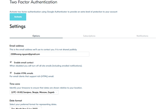

  • I am trying to download the SUPL, but I got the deni
    Dear Hoang,
    your application for SUPL-C license has been denied.
    Please click here to review the license agreement and contact Nordic tech support if you have any further questions.
    Best regards;
    the Nordic team
    Could you help. thanks
  • Hi!
    The rejection is based on your last login to DevZone (configured to within last four weeks), or if the email you used is not registered to DevZone, or if you are registered to the wrong country (listed in the license agreement).
    Do any of these apply to you?
    Heidi
  • The rejection is based on your last login to DevZone (configured to within last four weeks),
    No
    No
    Can you send it to my email ?
    Thanks
