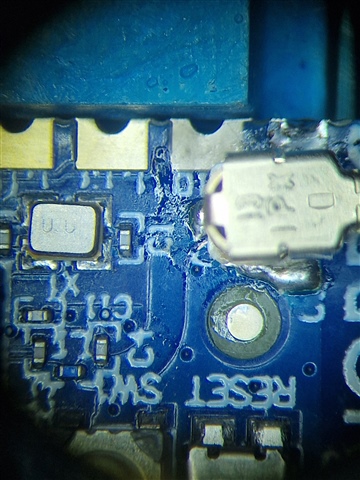

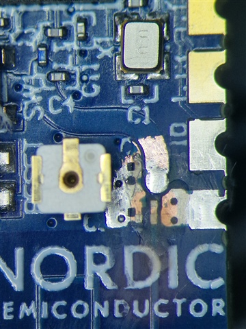

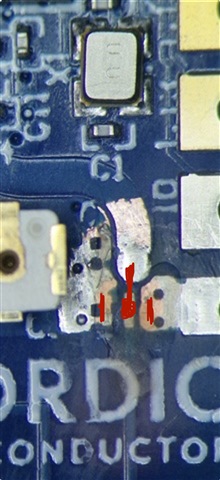

I'm about to develop a custom board with nRF52840 IC. For a first test I need an external antenna. I modified a dongle for a first proof of concept. I removed the antenna trace and soldered SMA connector on it. On the bottom side i connected the connector to the ground plane.
If I understand it correctly, I have to remove C4 and C26 for an eternal antenna design. On the development board, the C3 is 0.8pF and on the dongle it's 1pF. I think that would be ok for the first test.
Can somebody confirm, that the C4 and C26 have to be removed from the dongle, if I want to test it with external SMA connector?
