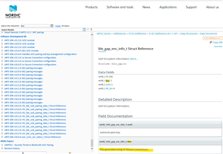

    Finally let me ask one question.
    One of the connection parameters is lesc. Even if this is false, can I say that this product supports Bluetooth 4.2 and 5.0?
    Thank you.
  • Yes, correct. The specification does not impose any requirement that you have to support LESC. Some applications don't event support pairing. The ble_app_uart, ble_app_blinky examples from the SDK for instance.
