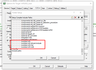

error: L6236E: No section matches selector - no section to be FIRST/LAST.
I am trying to run the ble_app_beacon example code for board pca10040 but I am getting the following error
.\_build\nrf52832_xxaa.sct(7): error: L6236E: No section matches selector - no section to be FIRST/LAST.
Not enough information to list image symbols.
Not enough information to list load addresses in the image map.
Finished: 2 information, 0 warning and 1 error messages.
".\_build\nrf52832_xxaa.axf" - 1 Error(s), 0 Warning(s).
Target not created.
Build Time Elapsed: 00:00:41
What seems to be the issue?

  • Yes both are same.
    You mentioned before that the project might using the compiler_abstraction.h file distributed with the SDK instead. Is this the issue? I checked the include paths for the following files and the paths are to the SDK files.
  • It shouldn't be an issue since you are using SDK 16. Both headers include the required symbol definitions. Please try the project attached below and see if you get the same build error. It builds without errors here and it would be interesting to see if you got the same result.
    ble_app_blinky_keil.zip
    Extract to \nRF5_SDK_16.0.0_98a08e2\examples\ble_peripheral\ before compiling.
  • I am getting the following errors
    Why is the path not from the SDK folder?
  • Good question. Mine are installed to C:\Keil_v5 and files such as system_nrf52.c are automatically imported to the /RTE folder adjacent to the project file. What version of uVision are you using?  I'm testing with v5.29.0 here. Have you tried to see if you can build the Keil4 project?
