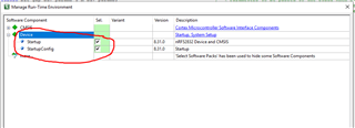

  • I managed to fix this issue by going in "Manage Run-Time Environment" > Device > selecting both "Startup" and "StartupConfig"
    Now I am getting the following errors:

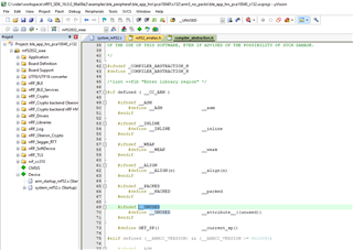

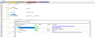

    Please try to uninstall the Nordic packs, then re-install the latest version and see if you get the same result. If it doesn't work, check if you have a 'compiler_abstraction.h' file located in your \Packs\NordicSemiconductor\nRF_DeviceFamilyPack\8.31.0\Device\Include\ directory and if it defines "__UNUSED". I suspect missing definition of __UNUSED is what is causing the build error.
  • Hi I am already using the latest version of Nordic deviceFamilyPack 8.31.0. I have also tires to uninstall the install previous versions and then install the latest version again. But nothing happened.

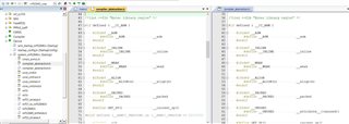

    Regarding the compiler_abstraction.h file I have attached the screen shot.

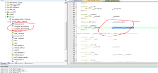

  • Hm, I get the exact same build errors if I comment out the definition of __UNUSED. Maybe the project uses the compiler_abstraction.h file distributed with the SDK instead. What SDK version are you currently using?
    The header file is located in  \modules\nrfx\mdk\ if you're using a more recent SDK release.
  • I am using SDK 16.0.0
    I checked the file path of compiler_abstraction.h file, its in "C:\Users\syeds\AppData\Local\Arm\Packs\NordicSemiconductor\nRF_DeviceFamilyPack\8.31.0\Device\Include"
