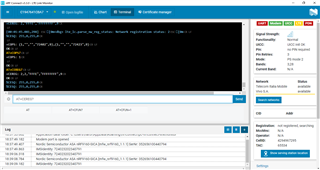

I am trying to connect my nRF 9160 DK and Thingy:91 to TIM (Telecom Italia Mobile) CAT-NB1 network provider from Brazil. I am using the Asset Tracker and mfw_nrf9160_1.1.1 modem firmware.
AT commands to attach the network:
AT%XBANDLOCK=1,"1000000000000000000000000100" -> B3 (1800MHz) e B28 (700MHz)
AT%XSYSTEMMODE=0,1,1,0 -> sets Cat-NB1 and GNSS as the system modes. No preferred mode set
AT+CGDCONT=1,"IP","nbiot" -> IPv4 and APN configuration
AT+COPS=1,2,"72402",9 -> PLMN configuration
It looks like I am unable to register to the network. I tested with the iBasis chip and works well and connect to nrfcloud but when i try to connect to my provider i have no success.
I am attaching the screenshot of the LTE Link Monitor and the log file.
Can anyone help me to discover my mistake?
LTE Link Monitor
OK
OK
OK
OK
AT+CFUN=1
OK
%XSIM: 1
AT+CPIN?
+CPIN: READY
OK
AT+CPINR="SIM PIN"
+CPINR: "SIM PIN",3
OK
AT+CIMI
724023202340791
OK
AT+CFUN?
+CFUN: 1
OK
AT+CGSN=1
+CGSN: "352656100440794"
OK
AT+CGMI
Nordic Semiconductor ASA
OK
AT+CGMM
nRF9160-SICA
OK
AT+CGMR
mfw_nrf9160_1.1.1
OK
AT+CEMODE?
+CEMODE: 0
OK
AT%XCBAND=?
%XCBAND: (3,28)
OK
AT+CMEE?
+CMEE: 1
OK
AT+CNEC?
+CNEC: 24
OK
AT+CGEREP?
+CGEREP: 1,0
OK
AT+CIND=1,1,1
OK
AT+CEREG=2
OK
AT+CEREG?
+CEREG: 2,0,"FFFE","FFFFFFFF",9
OK
AT%CESQ=1
OK
AT+CESQ
+CESQ: 99,99,255,255,255,255
OK
AT%XSIM=1
OK
AT%XSIM?
%XSIM: 1
OK
AT+CPIN?
+CPIN: READY
OK
AT+CPINR="SIM PIN"
+CPINR: "SIM PIN",3
OK
AT+CIMI
724023202340791
OK
AT+COPS=?
%CESQ: 20,1,15,2
+CEREG: 2,"A8F4","032B2628",9
[00:01:28.036,010]
[0m<dbg> lte_lc.parse_nw_reg_status: Network registration status: 2
[0m
+CNEC_ESM: 111,0
[00:01:30.668,579]
[1;31m<err> lte_lc: Could not parse AT+CEREG response, error: -11
[0m
[00:01:30.676,574]
[1;31m<err> lte_lc: Could not get network registration status
[0m
+CNEC_EMM: 15
[00:01:30.685,668]
[0m
[00:01:30.693,664]
[0m
+CEREG: 4,"A8F4","032B2628",9
[00:01:30.704,223]
[0m<dbg> lte_lc.parse_nw_reg_status: Network registration status: 4
[0m
%CESQ: 255,0,255,0
+CEREG: 4,"FFFE","FFFFFFFF",9
[00:01:31.057,952]
[0m
+CEREG: 2,"FFFE","FFFFFFFF",9
[00:01:45.081,298]
[0m
%CESQ: 255,0,255,0
+COPS: (1,"","","72402",9),(1,"","","72423",9)
OK
AT+COPS?
+COPS: 1
OK
AT+CEREG?
+CEREG: 2,2,"FFFE","FFFFFFFF",9
OK
%CESQ: 255,0,255,0
%CESQ: 255,0,255,0
