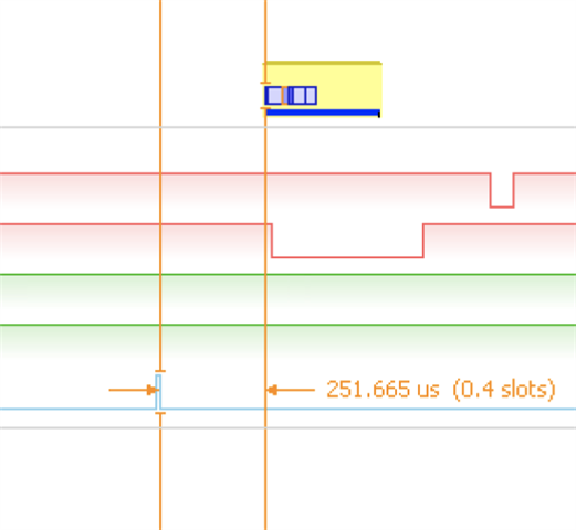

I have also verified the KSGEN is triggered well in advance of READY. I measured 251-us. Image attached below.
