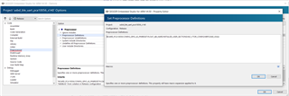

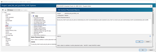

I am converting the the Project ‘usbd_ble_uart_pca10056_s140’ to pca10059, to download it in the nrf52840 dongle. I followed the steps in the nRF52840 Dongle Programming Tutorial and changed the processor and linker attributes. But an error is occurring when linking or creating the new pca10059 hex file. Is there any one how has ever done this conversion with a large software code ? I am new to these things and do not know how to set the parameters inside the linker.
These are the the changes as descried in the nRF52840 Dongle Programming Tutorial

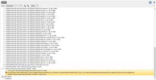

This is the error is popping up, after I do the changes and build the project.

    Sorry for the late reply. Since this example uses SoftDevice the only thing you need to do is to update the Preprocessor Definitions by removing BOARD_PCA10056 and inserting BOARD_PCA10059 and you should be able to build the example. You don't need to adjust the linker configuration.
    Did you check if you were able to build the example out of the box? It could be that your working directory is in a too deep level (i.e. long path name). This is a problem related to Windows path limitation, and is a known issue when the names get too long. You can try to move the SDK folder to level that is not that deep.

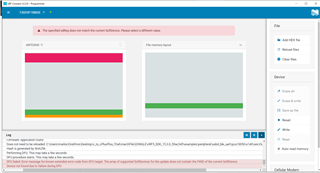

  • Hi, I tried your approach, it builds but I am encountering another problem related to the nrf connect app when programing the dongle.
    The problem is related to the SoftDevices. When writing the new hex file I chose 0XAE (s140_nrf52_6.1.0) for the sdk15.3.0.  I also chose 0XA9 (s140_nrf52_6.0.0) and all the rest just to try. But still I did not fix the issue.
    Is there something I am missing to do ?
    For SDK v15.3.0 you need to use Softdevice v6.1.1. You can find it under the folder components/softdevice/s140/hex/s140_nrf52_6.1.1_softdevice.hex inside the SDK folder.
    Click "Add HEX file" in the nRF Programmer app to upload a new Softdevice and then "Write".
