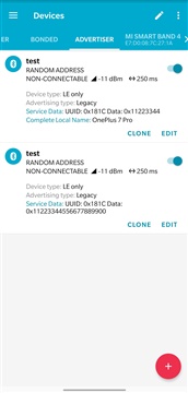

    I have changed back to default mode and now I can find other advertisements. However I found that only beacon with name can be found - I also tried create different advertiser in nRF Connect App and got the same result. Do I have to advertise the name to find them?

    Much thanks for explainations. I created two advertisers in nRF Connect which advertising the same Service Data. The only different is one with Complete Local Name and the other didn't - and the scanner can only print the packet which advertising with the name. That's why I wonder if it is necessary. Do you have any idea about this?

    There should not be any such restriction for the scanner in the beaconing example, no. It should detect all advertisements on the same phy as the mesh stack is running.
    It may be an issue on the sender side. Have you checked to see if you receive advertisements through nRF Connect? (Either a separate session of nRF Connect for desktop, or using nRF Connect for iOS or Android.)

  • Yes I tried... No problem receiving advertisements through nRF Connect for iOS, could discover them both.

    I'm sure I'm using the unmodified files. Here's what I tried:
    I create two advertiser which advertising User Data, the first one advertsing the Local Name as well.
    When I enable either of them or both, only the one with Local Name can be found during scanning (ADDR: [a4:e8:6c:8a:31:45]: 0E094F6E65506C757320372050726F07161C1811223344)

    I am able to reproduce. Looking into why this may be.
