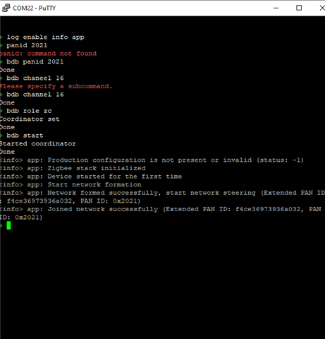

Hi , I am running zigbee cli example code from sdk and configuring nrf52840 board as coordinator and trying to add xbee module to zigbee network. Coordinator is not accepting those modules.

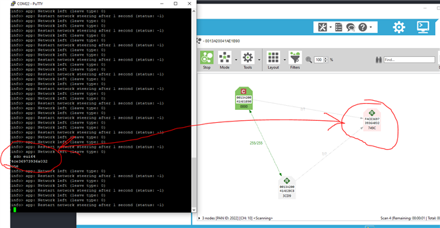

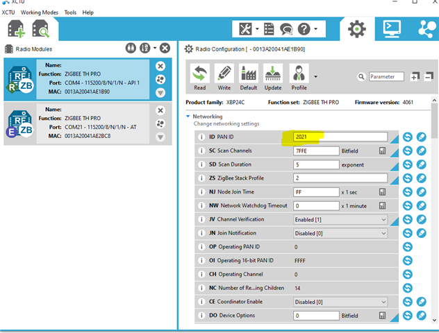

I am using xbee pro s2c modules . Yes I have used another nrf52840 (dongle) with sniffer firmware flashed on it for sniffing traffic . I am configuring nrf52840 dk running cli example as coordinator with a certain pan id and using the same pan id on xbee modules configured as routers but they are unable to join the network.
Coordinator settings
router settings
nrf52840 dk when configured as router is working perfectly fine with one xbee as coordinator .
Problem solved ! . Actually I was using wrong ext Pan id on xbee devices. Thanks for your reply.
