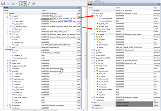

  • It seem struct value:libuarte wrong?In the picture,the left is libuarte demo,the right is my project.
    But both of them define libuarte by “NRF_LIBUARTE_ASYNC_DEFINE(libuarte, 0, 0, 0, NRF_LIBUARTE_PERIPHERAL_NOT_USED, 255, 3);”.
    I feel puzzled NRF_LIBUARTE_ASYNC_DEFINE only assign &libuarte_rx_pool to libuarte.p_rx_pool,but I could not find the defination of  libuarte_rx_pool in libuarte demo.why it got memory address?
    whether my fault is caughted by this?
  • Oh,it maybe keil's bug,when i emulation several times,struct "libuarte " look normal.and i know how "libuarte_rx_pool" defined.it also could find in .map.
    But problem still. how could i debug INVALID MEMORY ACCESS

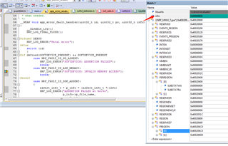

    The NRF_FAULT_ID_APP_MEMACC fault ID is triggered if the application has accesses memory that is reserved for the SoftDevice. From API doc:
    Application invalid memory access. The info parameter will contain 0x00000000, in case of SoftDevice RAM access violation. In case of SoftDevice peripheral register violation the info parameter will contain the sub-region number of PREGION[0], on whose address range the disallowed write access caused the memory access fault.
    From the screenshot, we see that info is 0x00000800, so you are using a peripheral that is reserved for the SoftDevice, or can only be accessed via SoftDevice APIs. You should make sure that the application does not use any of the restricted peripheral directly, and completely stay away from those that are blocked (most notably TIMER0 and RTC0, which is often used by examples that do not use the SoftDevice).
  • Thank you very much!!!
    In your guidance, I make it work! By set "NRF_LIBUARTE_ASYNC_DEFINE(libuarte, 0, 1, 2, NRF_LIBUARTE_PERIPHERAL_NOT_USED, 255, 3);"
