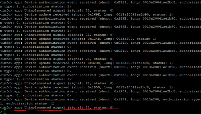

Hi ,
I am using nrf52840 dk running zigbee cli example in sdk . I have configured dk as coordinator and using xbee modules as routers . After successful addition of xbee routers , coordinator starts to show this log. "<info> app: Unimplemented signal (signal: 21, status: 0)" . I don't know why it is showing signal 21 and what does that means.
    If you look in the file zigbee_helpers.c (where the line that prints this line) is implemented you can see that this is an event handler, zigbee_default_signal_handler() with a switch for the different events. If you search for any of these events, you will see that they are all defined in zboss_api_zdo.h in an enum called zb_zdo_app_signal_type_e. The message simply means that this signal is not included in the signal event handler.
    Enums being 0 indexed, signal 21 refers to ZB_NLME_STATUS_INDICATION.
    Status = 0 means that the status is OK.
    Exactly what the event does I am not sure. You must try to add this event to your event handler, and look at the parameters. Read the description for ZB_NLME_STATUS_INDICATION in zboss_api_zdo.h on line 432-439. Check out the zb_zdo_signal_nlme_status_indication_params_t struct in the same file.
    Edvin
